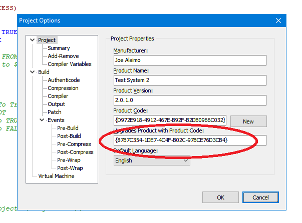

by FrancescoT
Both your projects are sharing the same identical "UPGRADE CODE".
To fix the issue, I assigned a "new and unique" upgrade code to "InstallTest1 Project".
(Ex.{2668A222-C724-4C50-9BB4-3506A79CEE95}).
One additional note, both projects also share an identical installation folder (Create Folder $MYAPPDATA$\FLFPPR).
This may be a problem if both installers store files under such location.
Re: 2 installs clash
Posted: Thu Jan 27, 2022 11:40 am
by joealaimo
Hi Francesco,
Thank you for finding this. This change did fix the problem. I had overlooked the upgrade code because I thought that this only applied to patches. Since we were not doing patches, I did not realize that this field was being used.
All the best.
