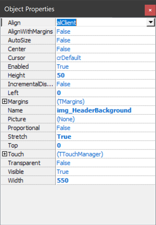

There're a few more things the TAeroPngImage control lacks, compared to the TPicture.
IA Object Properties TPicture.png (100.23 KiB) Viewed 4904 times
IA Object Properties TAeroPngImage.png (71.95 KiB) Viewed 4904 times
Also, in our projects we define variables that each holds the path to a bitmap file, which is part of the Creatives. This variable is then used as the name of a TPicture control on every dialog form and gets loaded at runtime.
So we don't need to change any forms between versions and projects, just replace the bitmaps.
The same scenario doesn't work with the TAeroPngImage. It remains empty.
My wish is that its functionality gets extended with all features that TPicture is providing.
