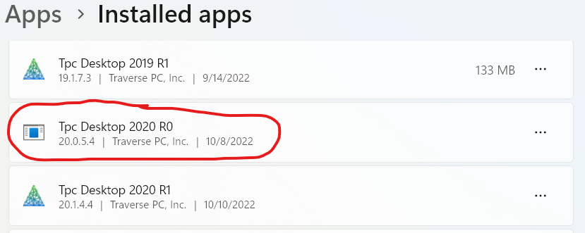

-We provide updated versions of our Win-32 app like 20.0, 20.1, 20.2 with any new version of 20.x replacing any older version of 20.x.
- Version 20.0 creates a setup file 2020r0Setup.exe, Version 20.1 creates a setup file 2020r1Setup.exe, etc. so we can have each minor version (20.0, 20.1, etc. version) available for download.
- Each version had an InstallShield project file.
-We converted these install projects from InstallShield to InstallAware.
-We used the Upgrade Code plugin to get the Product Code from InstallShields Upgrade Code and that seems to work fine. InstallAware installs the new version and the replaced version is gone from Settings, Apps.
-Our new InstallAware projects for version 20 all have the same PRODUCTCODE and reuses that for the UPGRADECODE code and every build uses a new REVISIONCODE.
-But when we install version 20.1, version 20.0 is still in Settings, Apps along with the new version 20.1 we just installed. We were expecting InstallAware to remove the replaced version from Settings, Apps.
How do we remove version 20.0 (version being replaced) from Settings, Apps?

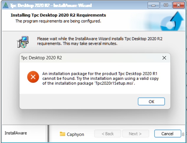

I put in the script you showed, making the change for \WOW6432Node\ and I get this message when line 41 executes.
Error Installing 2020 R2.png (121.49 KiB) Viewed 75673 times

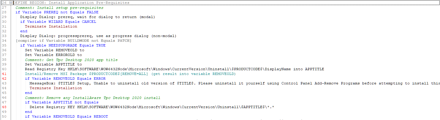

Here is my script
MSI Script for Error Installing 2020 R2.png (58.45 KiB) Viewed 75673 times
What am I doing wrong?

The reg key has to be:
HKEY_LOCAL_MACHINE\SOFTWARE\Microsoft\Windows\CurrentVersion\Uninstall
The OS redirects to "WOW6432Node" as necessary. By default, the installer runs in 32 bit mode. Consequently, the install entry will be stored/loaded into/from the 32-bit hive of the Registry.

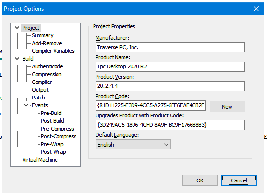

1) ProductCode must be the same across different versions of the same product (otherwise it will be not recognized as a product family upgrade).
2) UPGRADECODE has to be unique (different from ProductCode), but identical across different versions of the same product (for a correct product update and/or Patch).
viewtopic.php?f=2&t=9883
viewtopic.php?f=2&t=11273
Consequently, I changed the PRODUCTCODE and UPGRADECODE assigned to your projects "InstallAwareApp_2020R0" and "InstallAwareApp_2020R2" as follow:

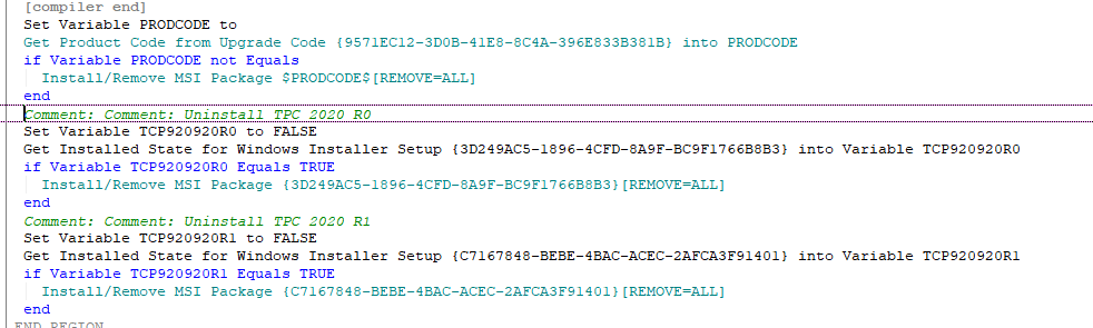

In addition, I made the following changes to your original code where you are probably detecting for the presence of non-Installaware packages that may be installed on the target system:
Finally,

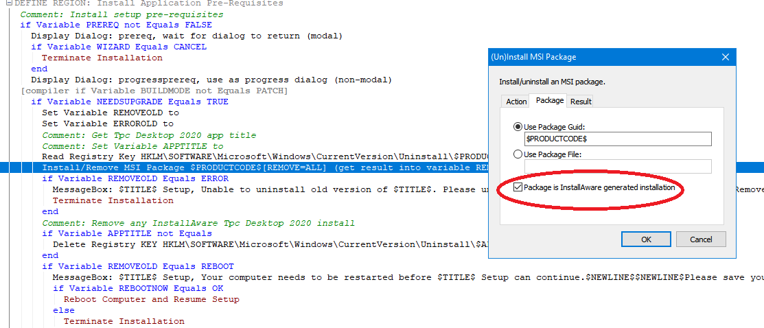

1) I had to enable the "Package is InstallAware generated installation" flag of the "(Un)Install MSI Setup" plug-in inside the block that removes previously installed version of the same product. Otherwise, it will fail to remove them ...as you reported previously. THIS SETTING IS ENABLED BY DEFAULT WHEN CREATING A NEW PROJECT
Check this field if the command will be used to operate on an InstallAware setup. This command will fail on InstallAware setups unless this field is checked. Checking this field for non-InstallAware setups is not recommended.

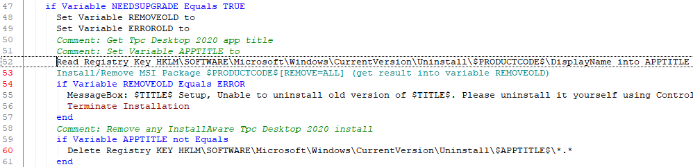

2) I have re-introduced the statements that removes possible orphans entry left on the system.
Of course, these modifications has to be applied to any other project of the same product family.
Attached, my edited copies of your projects "InstallAwareApp_2020R0" and "InstallAwareApp_2020R2" (I had to comment-out all the "Install Files" commands ...you didn't share your sources).

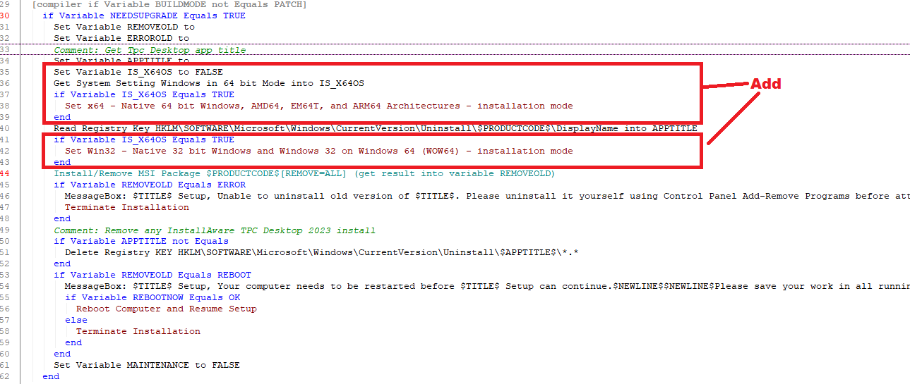

I've attached the project files for TPC 2023 R0 and R1.
Re: Old version still visible in Settings, Apps after installing update
Posted: Wed May 24, 2023 1:13 pm
by FrancescoT
Attached you find my edited copies of your projects.
I have applied the following modifications:

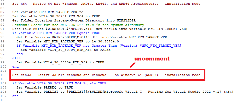

Step 1- At the very beginning of your main setup file (Tpc2023r1Setup64) you have to comment (it should be removed from there) the "Set x64 - Native 64 bit ... - installation mode" statement. The recommendation is to switch to x64 mode in the "Global Settings" REGION of the Main Setup Script file. Unless is strictly necessary (see Step 2), you may switch to x64 mode but you should switch back to x86 mode once done.
Step 2 - In your main setup file (Tpc2023r1Setup64) Apply the following modications within the "NEEDSUPGRADE" conditional block.
Step 3 - UnComment the "Set Win32 - Native 32 bit ... - installation mode" statement in the "checkVC14_30_30704_x64"
Finally, rebuild both projects.
