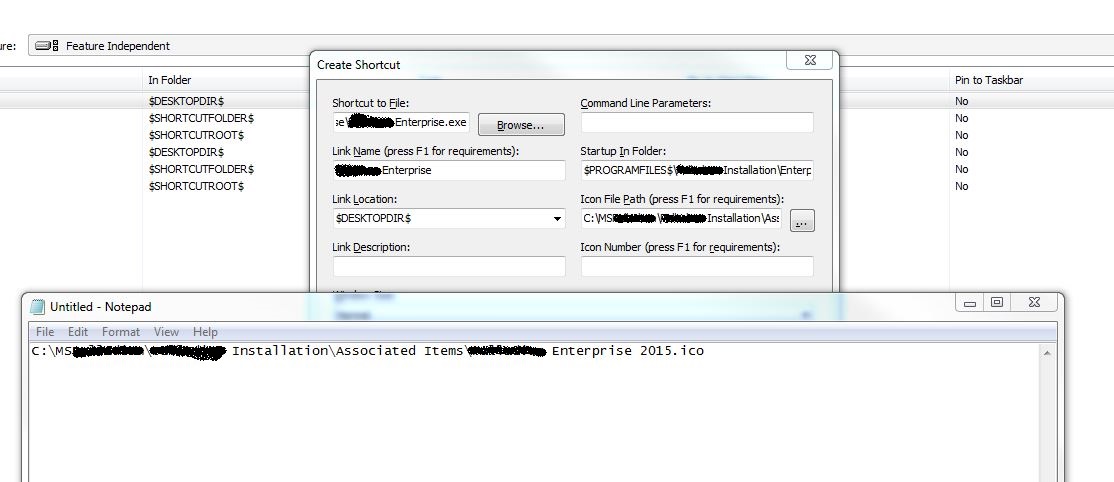

As an example, here is the icon details in IA:

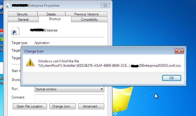

And here is the icon detail for the shortcut properties when I click on the button "Change Icon".

Thanks for your reply. My apologies for the confusion. So basically my problem is that the icon of the shortcuts is not displaying as the paths are not correct, which is what i was trying to show with the images in my initial post.

The fundamental parametrs are;
Shortcut to File = the target directory of your application (once installed)
Link Location = where the shortcut is stored on the target machine (the DESKTOP in this case)
Icon File Path = The path must point to a file on your development system ... no variables are allowed with Windows Installer Engine.
