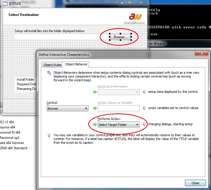

what you are reporting is not due a bug with the "ShellList component", but it's just because that control cannot work under a system account context. To solve your problem, you need to replace such control with a more simple "Browse for folder dialog". This is exactly what I done with all my projects and when these needs to run under a System Account Context.
viewtopic.php?f=2&t=10656&p=41155&hilit=browse#p41155
Then, run the package in silent mode (under system account the installer has to run in silent mode Always ... you cannot browse for folders) as follow;
> psexec -i -s <setup.exe> /s
*With a setup exe is generally not necessary to pass ALLUSERS=TRUE. This should be TRUE by default already.
