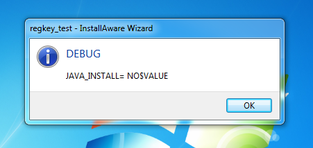

Re: X5 Multiple Questions
Posted: Tue Nov 08, 2016 5:23 pm
by essulzer_tltd
That is a very valuable piece of information there. I appreciate that, and I am sure it is going to make things work a lot better!
I am back at problem 1. I have forced the 64 bit native mode (where appropriate), checking for the following key: HKLM\SOFTWARE\JavaSoft\. From my research, the only 2 values this key should return are NO$KEY or NO$VALUE. I am checking for and receiving NO$VALUE but the conditional statement is not launching. Please see code snippet below. This specific machine is an HP laptop.
Posted: Wed Nov 09, 2016 4:00 am
by bokkie
I get the result NO$VALUE as well. I put a message box inside the "if" and it's being displayed. However, when I display the JAVA_CHECK variable, it displays NO$KEY but inside the "if" you have checks for 1.6, 1.7 and 1.8 but there's no other check for anything else. That would give the impression the "if" isn't being run as you expect? That is it's running quietly without really doing anything by the way of feedback.
Can you put a message box inside your "if" where you check JAVA_INSTALL's value if only to prove 100% that the"if" is or isn't working?
Another thought comes to mind. Is the "if" block itself inner scope to another "if", perhaps something that checks for a specific OS or some other resource known to your HP laptop which is environmentally different to another machine where it does work? :?:

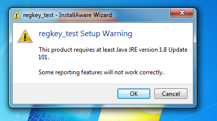

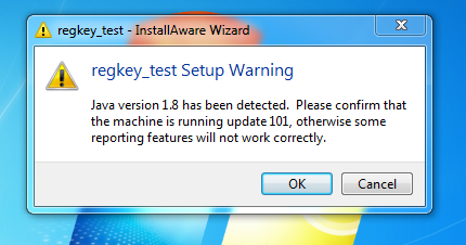

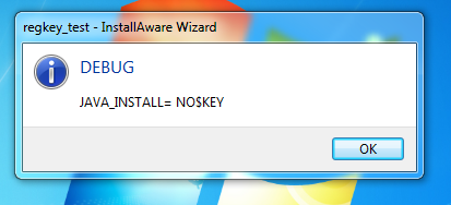

Posted: Wed Nov 09, 2016 8:03 am
by FrancescoT
Dear Essulzer_tltd,
attached you find a very small project that I used to verify your script. For what I see this works correctly and as follow.
Without any Java RTM installed;
...then
with the Java RTM installed "v.1.8";
...then
NOTES!
- it's not necessary to use the x64/x32 mode switch. This due the fact that the Java RTM is Always installed as native 32 bit package. Consequently on a x64 target OS, its registry Keys are Always stored under the 32 bit node of the target registry.
- I used a Win 7 x64 machine to test the code. With this specific OS I found that the key "HKEY_LOCAL_MACHINE\SOFTWARE\Wow6432Node\JavaSoft" seems to be present by default with the system. Of course by default this is empty (...the Java RTM is not installed), but maybe, this key may be not available by default with all Windows versions ... so probably, this may explain the different behavior when using different target systems.
