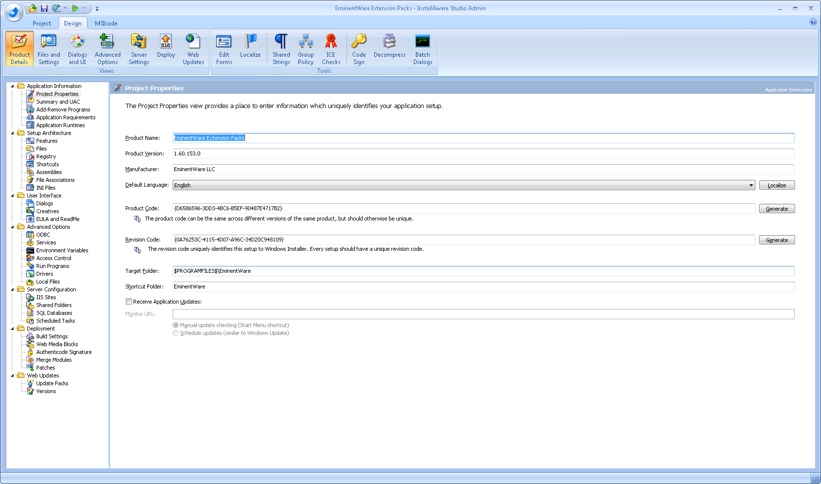

Secondly, you are assuming we dont change the title of the install at runtime, which we do.
Here is snapshot of the project info...
This title, other than a case change of the text, matches the MessageBox title window as you can see.
So, saying this isnt being generated from IA doesnt seem correct.

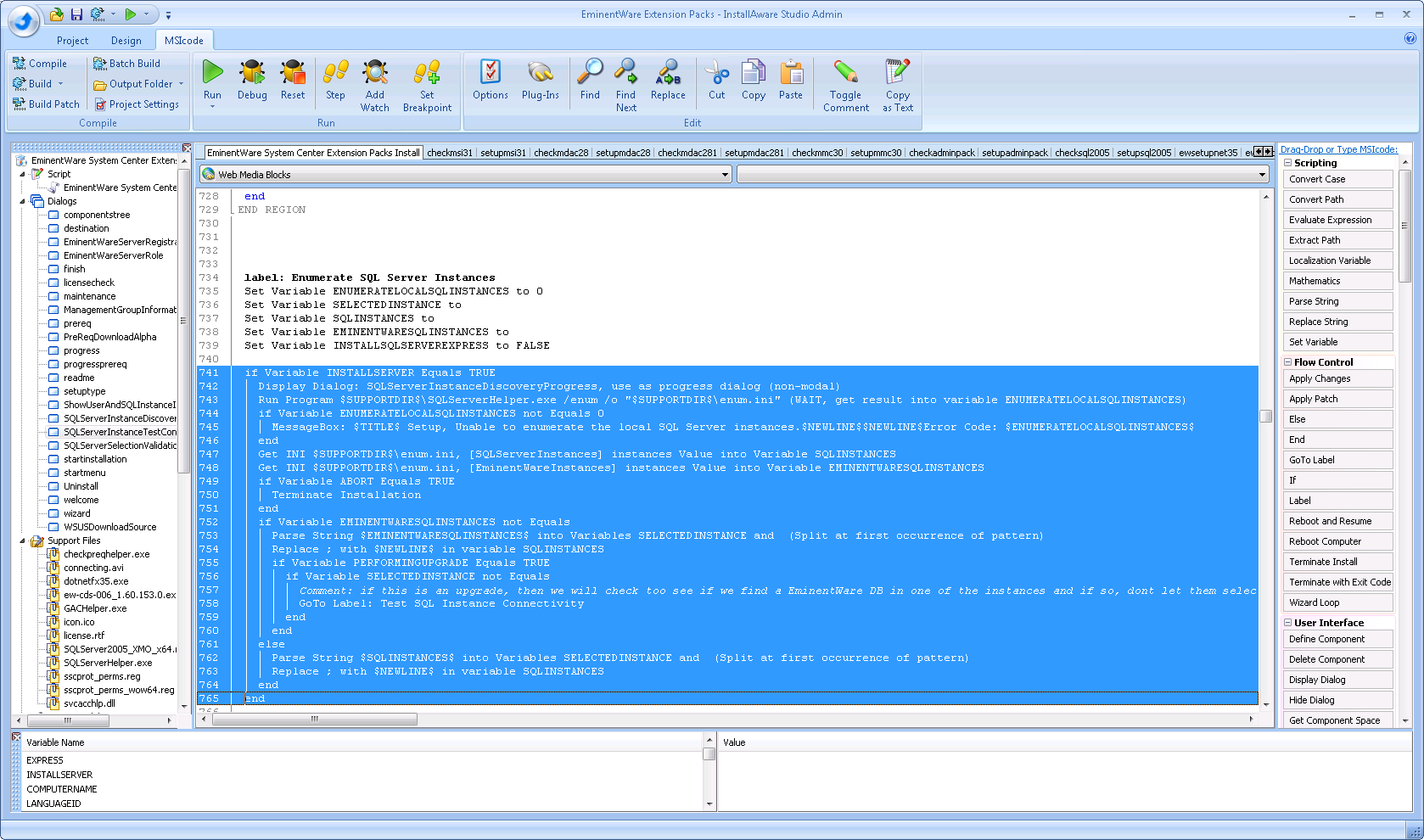

Here is a snapshot of the code where this issue is happening...
So, from the code, you can see that we DO trap the return value/message and we DO display a message box if there was a failure.

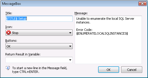

Here is the message box property dialog...
So, as you can see, that message box would NEVER display the message you are seeing, but rather something quite different.
