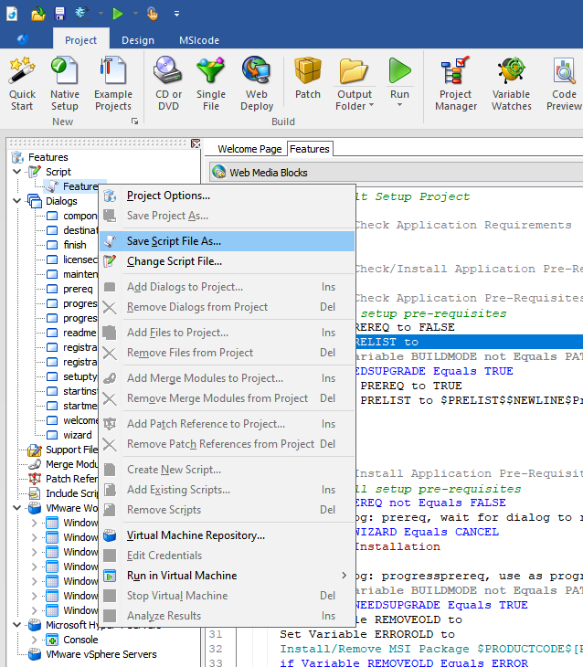

How did you create your new project from your previous one?
I suppose that all your problems are due the fact that your new project is still inheriting references from your original project.
To create a CLONE of a project, you can make a copy of the entire original project folder or use Project Save As as well. Once you copied your new project into your new folder, load the new project in IA, and then update your new project in order to use the correct MAIN script file under the new project folder.
To proceed with: from IA IDE switch to MSI code view, from the left tree pane select the main script file under the Script node, then Right click it and choose "Save script File As" to store it under your new location.
Finally, assign a new PRODUCTCODE and a new UPGRADECODE to the new project.
