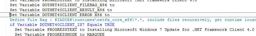

The problem happens here. Some how the FileBag (is it a Win 8 issue?) is not able to handle the space inside of #IADIR#. Putting quotes around the whole thing or #IADIR# doesn't help.

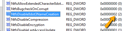

I found this thread: http://www.installaware.com/forum/viewtopic.php?p=15425, and sure enough (gasp!)
Will look into flipping the bit for my drive. Sigh.... hope future versions of IA support not having 8dot3 naming.

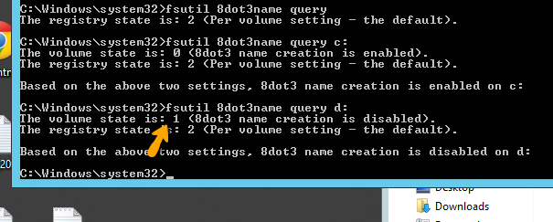

In case anyone else runs into this insane issue, here's the fix. In an admin command prompt,
D:\InstallAware>fsutil 8dot3name set D: 0
Successfully enabled 8dot3name generation on D:
D:\InstallAware>fsutil file setshortname "InstallAware 15" IA15
D:\InstallAware>dir * /x
Volume in drive D is Data
Volume Serial Number is 50BF-9A4C
Directory of D:\InstallAware
03/13/2013 01:40 PM <DIR> .
03/13/2013 01:40 PM <DIR> ..
03/13/2013 01:07 PM <DIR> IA15 InstallAware 15
0 File(s) 0 bytes
3 Dir(s) 1,158,114,119,680 bytes free
D:\InstallAware>fsutil 8dot3name set D: 1
Successfully disabled 8dot3name generation on D:
If you have other paths that have spaces, you may have to add 8dot3name there as well.

Many thanks for sharing this very useful information ... I didn't know that by default path shortname attibute is enabled on system drive only.
