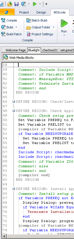

With the new build I cannot find how to see the include scripts etc that used to appear in the tree on the left of the app
Re: MDAC281 Add-in causing an Access Violation
Posted: Tue Jun 25, 2013 9:08 am
by FrancescoT
Dear Sean,
I'm currently installing the new IA 16 update ... but I suspect that you probably have accidentally closed the Left Tree pane window.
Could you post a screenshot?
Posted: Tue Jun 25, 2013 9:17 am
by Sean Flook
I have attached the screen shot as requested
Screen Shot
Screen Shot
InstallAware 16.png (25.32 KiB) Viewed 8625 times
Posted: Wed Jun 26, 2013 11:30 am
by FrancescoT
Dear Sean,
you are right ... I found the same.
A new IA update has been made available to solve the issue. It doesn't require license regeneration but you need to reinstall the package.
Alternatively, the Project Manager left tree view pane can be manually placed once again at its default position.
Swith to Project View in IA IDE and click the " Project Manager" button. Anchor the Project Manager tree view pane to the right of the IA IDE.
Switch back to MSICODE view and finally, anchor the Project Manager tree view pane to the left of the IA IDE.
