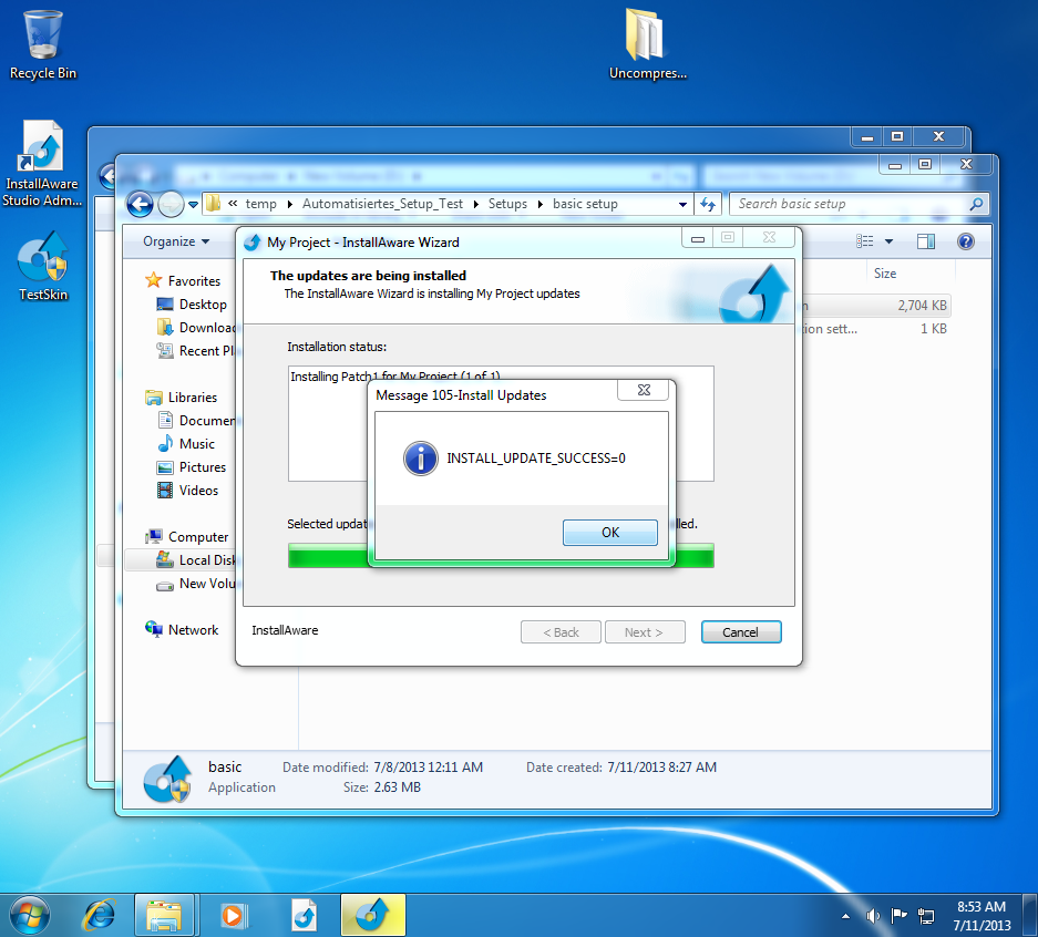

I have tested your package as by your steps and it works fine.
This is the screen-shot of the result message-box;
Honestly, I suppose the problem you had could be caused by the patch execution.
What you receive as return code from the Run Program execution, it is very probably, the result of the patch package execution and not a failure of the command execution itself.

For your convenience, you find attached the screen-shot sequence produced when I tested your package.
