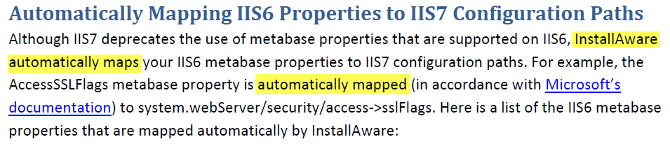

I understand what is being said however, it seems to directly conflict with the InstallAware documentation.
So do I have to use the "system.webServer/security/access‐>sslFlags" syntax or is it 'automatically mapped' when I use 'AccessSSLFlags'?
If I have to use the IIS7 configuration path (system.webServer/security/access‐>sslFlags) how do I identify the correct location, is it "[location:path=$Website$]/system.webServer/..." or something different?
As you see below <system.webServer> is within the <location> element and there is more than one <location> so simply setting the value to "system.WebServer/..." will not access the correct website.
Also, do I set the value to 8 or Ssl or "8" or "Ssl"?

I am not an IIS expert, but for what I understand by the InstallAware documentation in accordance with Microsoft documentation, if you don't use the "Use IIS 7 Processing" mode with the command, the given IIS6 Metabase Property (if within the list) will be automatically mapped to the IIS7 Configuration Path.
So if you pass with the command the IIS6 Metabase Property "AccessFlags", this will mapped to the respective IIS7 Configuration Path.
Anyway, this is not what InstallAware says, but what Microsoft reports with its documentation.
