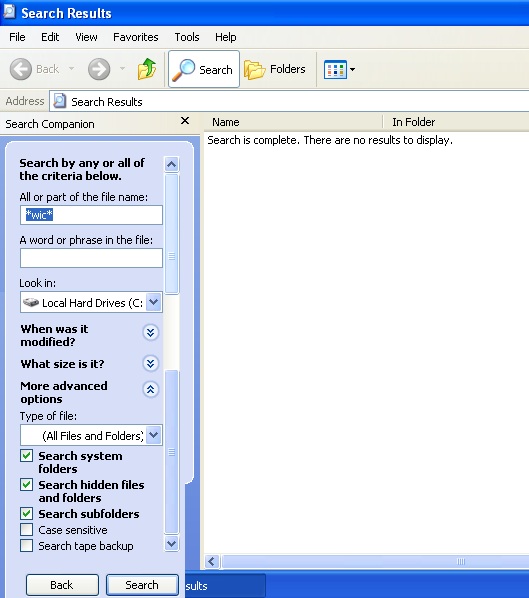

by mills
I still want to know if this file is showing up on a search for you (or where this file is located so I can see if it's on the system I'm testing). Whether I search before or after installing .Net 4 on a relatively fresh copy of Windows XP, I get the same result:
