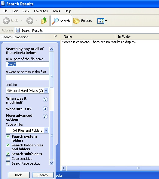

Re: Framework 4.0 Pre-req missing
Post by mills »
Is WIC_x86_enu.exe showing up for you in a file search? I searched all folders, hidden files, with no result on an XP SP3 machine. The file isn't found on a search after installing .Net, either...
Post by mills »
I still want to know if this file is showing up on a search for you (or where this file is located so I can see if it's on the system I'm testing). Whether I search before or after installing .Net 4 on a relatively fresh copy of Windows XP, I get the same result:
CFConner
Posts: 85
Joined: Wed Jan 21, 2009 4:14 pm
Location: Syracuse, NY
Post by CFConner »
I'm sorry that you are having problems - but like I said - Windows XP SP3 has the WIC components installed.
Andy, you will not find *WIC* files on the system. The DLL's have different names. :)
