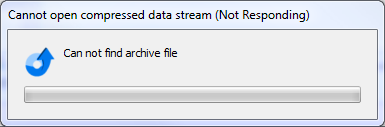

Also when the installer starts up I get this dialog:
which I think is not supposed to display an error message (as no error occurred) but is supposed to say something like "Extracting archive file" or such.

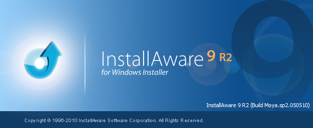

And when I bring up the splash screen of the Installaware application I noticed it actually says Release 9 ?????
Is there a new update coming soon? I can't have users see error messages when there are none.
Re: Wen cancelling an install a strange dialog shows
Posted: Thu Jul 07, 2011 10:22 pm
by giaviv
It is very strange you are getting these error messages. Something must have messed up your installer shared strings.
Try creating a new project from a template (basic setup for example). Are you experiencing the same thing?
If so, please uninstall InstallAware and install it again.
Posted: Tue Jul 12, 2011 2:44 am
by smeyn
THe issue has been resolved. I was using the wrong licence key for a prior version. Using the right licence key fixed it all up.
