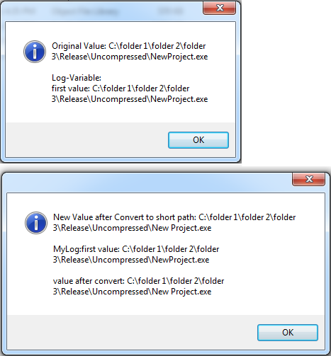

Re: Convert to Short Path problem
Posted: Thu Aug 11, 2011 5:29 pm
by giaviv
I built & ran your project and it seems to be working just fine:
