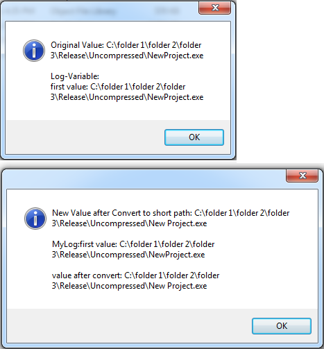

I built & ran your project and it seems to be working just fine:
