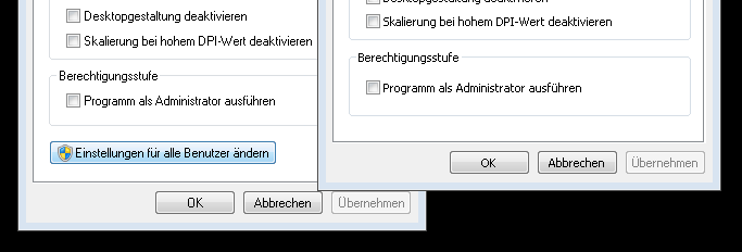

Problem fixed, but the "run as admin.." option is not visible in the link property dialog.
Is that correct ???

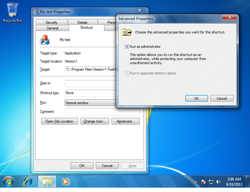

"run as admin.." is visible with the property dialog or right clicking the application link.

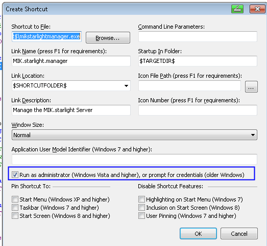

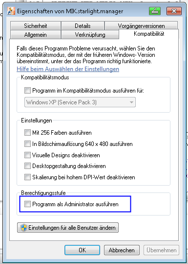

Still the same problem with 14.03. It is really annoying.
We use German OS! Maybe is that the problem ?????
my code:
~InstallAware Clipboard Data~
~End~
~{EE904950-0AFC-43BD-AD7A-3798E1691E5F}~
~Create Shortcut~
~{E121B7BB-E521-4E11-9E4E-3CEFB00FBE6F}~
~$TARGETDIR$\mikstarlightmanager.exe|FALSE~
~MIK.starlight.manager~
~$SHORTCUTFOLDER$|FALSE~
~Manage the MIK.starlight Server~
~$TARGETDIR$|TRUE~
~|FALSE~
~0|~
~If~
~{BC81B32C-F228-4992-9D96-0794F1ADEAD7}~
~createstartmenu~
~3~
~true~
~FALSE~

you are checking in the wrong place.
InstallAware applies the "run as Admin" setting to the shortcut and not to the Compatibility properties of the application.
