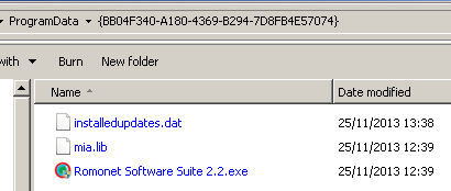

At this point, the value in EXEDIR is "Program Data\{GUID-of-previous-version}", which is why 'installedupdates.dat' ends up there instead of in "Program Data\{GUID-of-updated-version}. So, when I repeat the process, the Updater doesn't know that the update has been installed.
I attach screen captures of the two folders in Program Data. You can clearly see that the timestamp for 'installedupdates.dat' is later than the timestamps for the files in the folder for the new version.
This also begs the question - why is the old folder not removed? I can't see that the old mia.lib and MyApp.exe are still required.

- oldVersionFolder.png (6.28 KiB) Viewed 7041 times
- newVersionFolder.png (16.49 KiB) Viewed 7041 times
