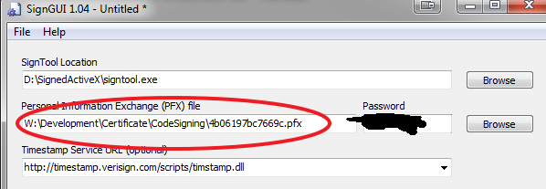

Here is a snapshot of the manual signtool file path -

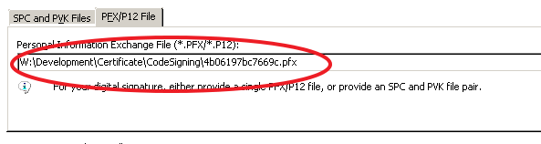

Here is a snapshot of the Install Aware file path -

- File Path For InstallAware

For what I see by your screen-shots, I suppose that it is probably caused by the miss-spelled value enterd with the timestamp URL.
It should be;
- http://timestamp.verisign.com/scripts/timestamp.dll
instead of;
- http://timestamp.verisign.com/scripts/timstamp.dll
It should be;
instead of;

After going through my entire process again, I realized that InstallAware was running in a different OS. It appears
to boil down to a Windows Server 2003 failing and Windows 7 working. Not an InstallAware issue.
