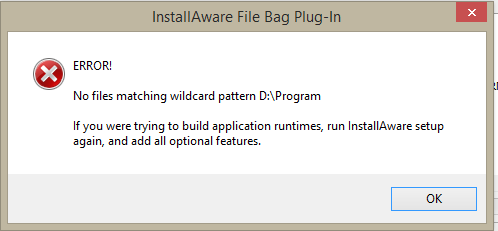

I have an error with the latest buld of InstallAware Studio which was already reported. See here:
Even applying the patch described in the other post, the error remains. The adress D:\Program is not referenced in anything inside my script or data I add. So, I'm not able to build a setup.

Dear Ueli,
first of all there isn't any patch available, you only need to download the latest IA X2 trial (19.03) and then to install it (don't forget use a new re-generated license file to activate the product).
For what concerns the problem you are reporting, please follow the steps described with the following post.
http://www.installaware.com/forum/viewtopic.php?f=2&t=9469
The error you are reporting seems caused by the "8.3 filename" settings with the drive you used to install IA.

Re: Erro with File Bag Plugin
seemed to be the problem. Other work around is to adapt the script variable manually.
