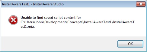

I am unable to build with X4. I downloaded X4 yesterday (4/10/2016) and installed it today. I first encountered the problem with my X2 project file, but I experienced the same problem with a new, empty project. I would send you the new, empty project, but I get this error when I try to save it:

For what concerns your other error with saving the project ... I really suppose that this has nothing to do with IA ... try to save the project under a different path, it may be probably a privilege issue or that file is locked for some Unknown reason.

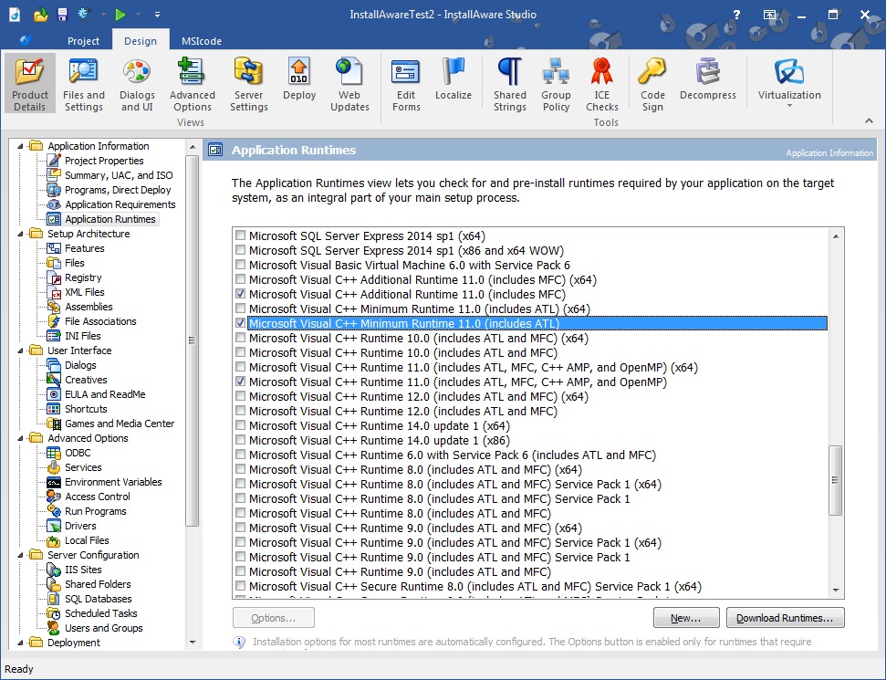

Yes. I created a new .NET Setup from the template. Then I added the following Application Runtimes:
.NET 2.0 with Service Pack 2
.NET 2.0
.NET 3.0 Service Pack 2
.NET 3.0
.NET 3.5 with Service Pack 1
.NET 4
.NET 4.52
Visual C++ Additional 11.0
Visual C++ Minimum 11.0
Visual C++ 11.0 Runtime
(I know, I don't need the Additional or Minimum. I checked those by accident)
None of the above were x64 versions, unless they were combined with x86.
After adding checking these boxes, I immediately started a single file build. I didn't save the project before the build, and I didn't navigate to any other area of the GUI.
I can send you the zipped project, but it is large (about 1GB).
As I mentioned, this problem is intermittent. Case in point: after performing the above steps and getting the build error, I saved the project, unchecked the Additional C++ and Minimum C++ runtimes, and started a single file build. This time, it built successfully.
JAB

Re: Unable to build with X4
Dear Jab,
you just need to send the Whole project folder ... so this can't be so big (whitout including the "release" folder).
Anyway, I cannot replicate the same using my machine. Due of this, I can only suppose that there is something with your system.
Do you have any Anti Virus installed?
