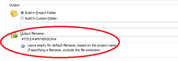

Dear Edhy,
it's not available a pre-defined compiler variable at such purpose ... you may use a custom compiler for that.
At any rate and assuming the same sample project, you may simply do as follow with the build settings.
Re: Place version number in output filename
Hi Francesco,
Thanks for the prompt reply.
Great, it worked!!!
Great, it worked!!!
