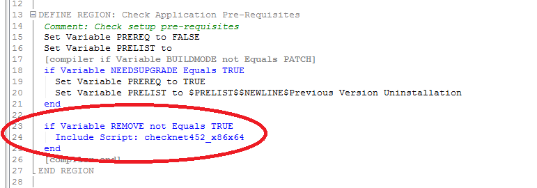

Dear Anja,
use the "REMOVE" pre-defined variable to conditionally execute the respective "checkxxx" Runtime script.
For example; supposing the project includes the "Net Framework 4.52" RTMs, it's just necessary to skip the execution of the respective "checknet46_x86x64" on un-install (REMOVE = TRUE).

Re: Setup installs runtimes on uninstall
Works fine, when starting the remove from the Control Panel;
does not work when starting the Setup manually.
Anja
Anja
Dear Anja,
you may try to include with the check, the value of "MAINTENANCE" pre-defined variable.
