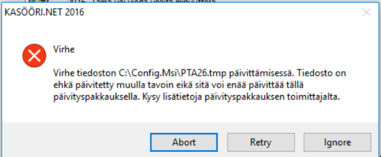

This one says that C:/Config.Msi/PTA26.tmp cannot be updated because it has been already updated by other means. I don't have a clue about what this file is.

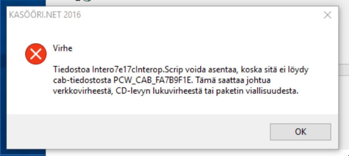

This one says that Intero7e17cInterop.Scrip cannot be installed because it is not found in PCW... This may be due to a network error, error reading a CD or corrupt package. There is no such file in any of my packages, but the original install does include a Interop.Scripting.Dll file. This is included in the patched project as well.
