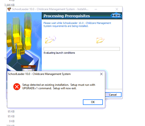

I'm getting this message also on an existing installer that has worked for over a year. The message is occurring in the very early steps. I don't want to start adding UPGRADE=1 to everything because I still have no idea what it means. This is not an MSI command line switch so it must be something from Installaware.
Francesco, can you explain this switch in more detail, and also, any idea why I'm getting it as well at a different spot? Only hint I can provide is that the customer reported that the installation "crashed" and when they tried to restart it this message appeared. A reboot did not help

Re: Passing command UPGRADE=1 to msi.
Update to my last post; Uninstalling Crystal Reports and then rerunning the installer worked. So, like the OP, the issue was Crystal Reports for me as well. Strange because it was already installed from a prior install (this was just an update).
Still would love to have some insight into this switch, if anyone knows. Thanks.

Dear Spicymikey,
it's the "Crystal Reports" RTM package installer that requires that "UPGRADE=1" parameter. For what I see, this seems to be necessary in order to upgrade an existing installation of the same RTM. So this is not a MSI or Installaware switch.
Ahh, thanks for that insight. Never knew that.
Not sure why it happened, but intervention by our support team to uninstall Crystal, solved it. Still not certain what that switch does. No hits for it on a web search. So we will leave it off for now.
