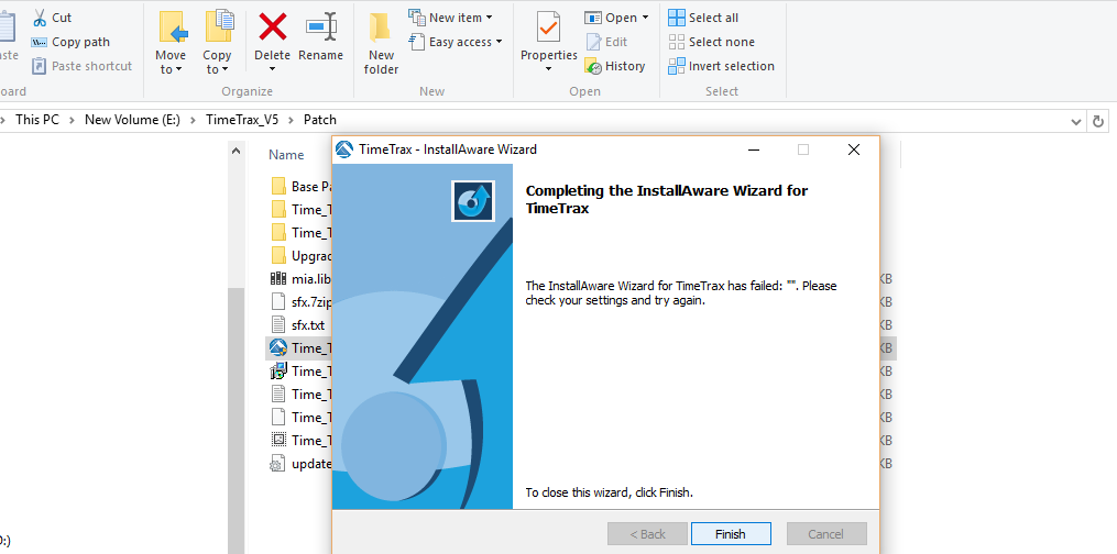

We are using Installaware X3.
When we install the Patch it starts the installation but it breaks in the end saying Installaware wizard has failed :" ". Please check your settings again.
I have been trying to figure out what is the issue but no luck. Could you let me know how to find out where it is breaking?

Re: Patch Installtion Failure
Hi
i did that. File says product installed successfully but i still get the error at the end.
I am attaching the log file. Could you help me out with this.
I have been working on patch since last entire week but still no luck.
I am attaching the screenshot of the error too.
Dear Archanad,
because the log doesn't report any error, it looks like that your package gets installed correctly.
Did you check if all its components are properly installed with the target machine?
If the package gets installed fine and this seems to be effectively true ("MainEngineThread is returning 0" as reported by log), are you sure that doesn't exist an error with your script code instead and that by mistake, you are not manipulating/altering the code returned by the "Apply Patch/Apply Install" command?
I have the suspect that your script logic reports an error which doesn't exist in reality.
Dear Archanad,
by default the results of "Apply Patch" and "Apply Install" are returned to the SUCCESS pre-defined variable (main Script). Then still by default, the same variable is used by the Finish dialog to display the message that you see.
