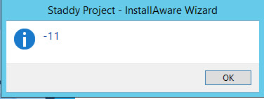

I have a batch file which i deploy at target computer and trying to execute the batch file. i have already given Required Administrator check in the beginning.
File get deploy at required location but does not execute gives message -11.
Here is the code line i used
And the Result is :
Is anything i am missing or required to do prior to execution of Batch File?
Any Help would be appreciated!!

I think under Run Program you need to put C:\WINDOWS\system32\cmd.exe
and as Command Line Parameters /c call <pathtobatchfile>
