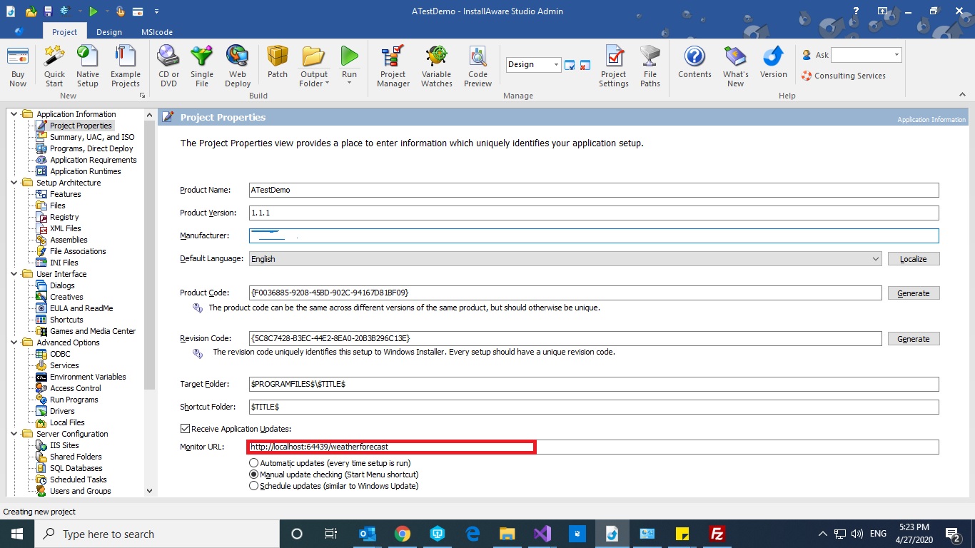

hello,
I have configure monitor url in project property but i have to call my application with monitor url.
so can i do that ? if yes then how ?
regarding monitor url

- Moniter URL.jpg (285.01 KiB) Viewed 4233 times
Re: regarding monitor url
In the Monitor URL field, you have to specify your update information URL. This URL is then used by the Web Updates process to download your update information file (updates.ini).
The "Web Update" topic (IA Documentation) contains a detailed description on how the whole process works.
https://www.installaware.com/mh5/desktop/webupdates.htm?rhsearch=web%20update&rhsyns=%20

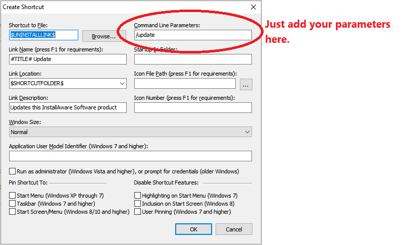

hello,
Thanks Francesco for support me but i have to pass parameter with update exe which is create in start menu. like
$TITLE$ update.exe /update <parameter>.
for that what i have to do ?
If I haven't missed your question, do you want to specify command line parameters when creating the Start Menu shortcut?
If so;
If so;
