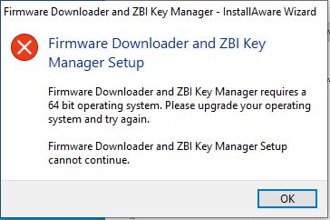

Can you please post a screen-shot of the error?

Thanks Francesco,
Here is a screenshot of the error.

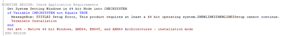

This should come out from your setup script ...due the presence of something similar in your code:
I suggest you to check also the application runtimes consumed by your project. It may be possible that you are including a RTM package which is designed for the x64 platform only.

Thank you Francesco.
The problem lay actually in the VS dependable that got included and was the only thing that has changed.
In the top of the checkvc14rtm_update1_x64 (included in IA installation) has a check for the 64 bit OS but for some reason there were both included without a check on the OS.
Now surrounding those two scripts with an OS check it works.
Thank you for your help.
