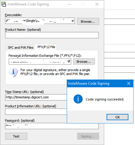

I just run a test using the "IA Code Sign Tool", and I don't see any problem.
Of course, as I have already discussed here (https://www.installaware.com/forums/viewtopic.php?f=2&t=11319#p43133), I had to use "http://timestamp.digicert.com" for the time stamp server.

Re: Authenticode code signing failure with X10
Thanks Francesco,
I ran your two signing commands with my certificate and a file to sign. Both worked successfully and yet the "IA Code Sign Tool" and IA X10 itself report an error when signing the installer. What could be the cause of that?
