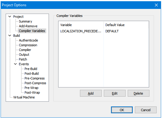

With the script code you can define a SCRIPT VARIABLE and NOT a COMPILER VARIABLE.
Compiler variables (identically as it is with any other development tool) must be defined with the project (SHIFT+CTRL+F11).
For more details, please search for compiler variable in the IA documentation.
