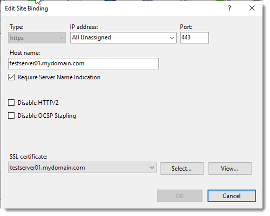

Hi All,
Is there any way when creating bindings in IIS to tick the option 'Require Server Name Indication' (screenshot below) - I cannot seem to find a way to do this in the UI of installware.
I thought I would try and work around this by instead using a PowerShell script (see below), but for reasons I cannot figure out, the script will not work - it creates the SSL certificate fine, but will not create the binding and assign the certificate. If I run this same script manually in PowerShell ISE, it works perfectly.
Would anyone have any ideas how to do this in Installaware UI, or why the PowerShell script will not execute properly?

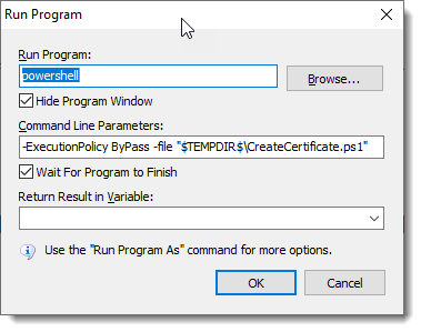

How did run your ps script from IA script? Did you use "Run Program" command?
Re: IIS and Server Name Indication (SNI)
Hello Fransesco,
Yes, I used the Run Program syntax below. I know the script is running, as it's creating the self signed certificate. It's just not executing the other New-WebBinding and New-Item commands.
Thanks very much for your help so far.
Mark
Mark
mmm ...very strange indeed.
Can you do a try with omitting the "Hide Program Window" flag?
This should leave visible the Powershell Console Window while executing the "Run Program" command.
Probably, the console window will also report some more details about the nature of the problem.
