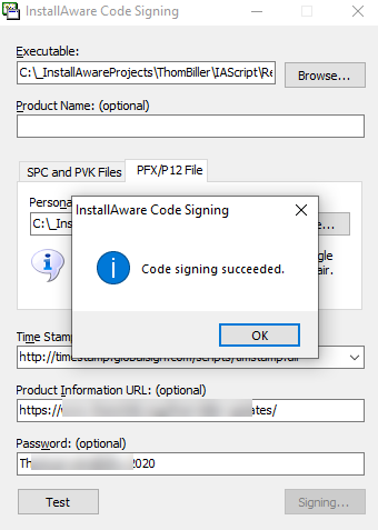

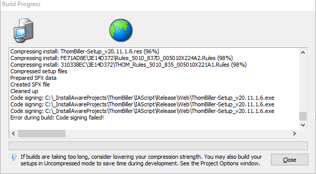

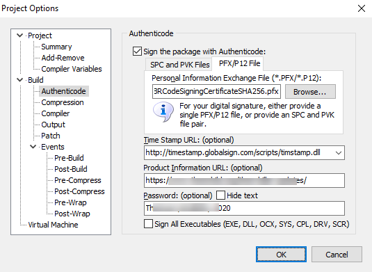

Hi Francesco,
I am having issues with signing my install file from X12 IDE. When using the "InstallAware Code Signing" application with the same values, then it will work.
I am attaching images of the process in the IDE which fails all the time and the process using the external code signing application.
The problem with the external code signing application is that we have to enter the values all the time we need to sign a file.
- Code signing succeeded
- Code Signing suceeded.png (26.51 KiB) Viewed 16718 times
- Code signing error during build
- Code Signing Error during Build.png (22.75 KiB) Viewed 16718 times
- Project Option - Authenticode
- Project Options - Authenticode.png (33.41 KiB) Viewed 16718 times

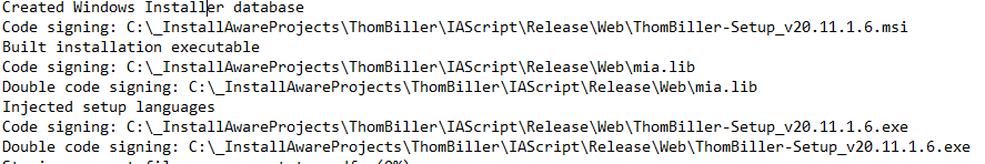

Hi Francesco,
Thanks for the prompt reply.
Unfortunately this TimeStamp URL also failed, but notice that it will only fail for the last process, other files are being signed as per the image attached from the build.
- IA Build process.png (17.96 KiB) Viewed 16704 times

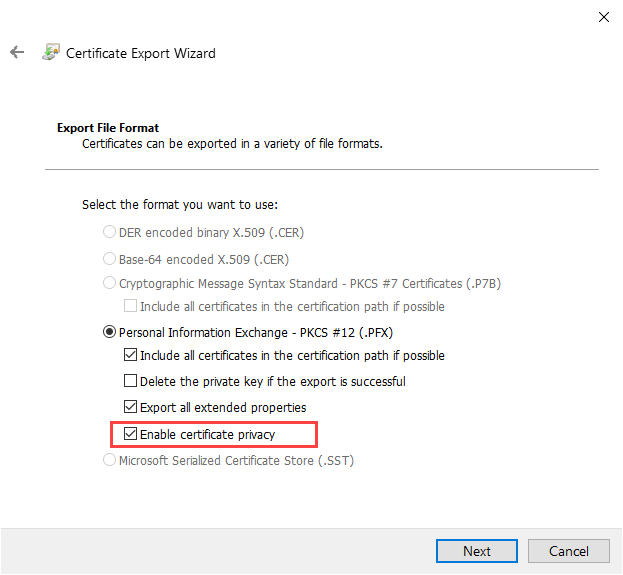

Hi Francesco,
Actually this URLworked after I re-exported my certificate with the option "Enable certificate privacy" checked. My certificate provider suggested on their tutorial https://ksoftware.freshdesk.com/support/solutions/articles/17157-how-do-i-export-my-code-signing-certificate-from-internet-explorer-chrome-or-safari-on-windows- that this option to be optional, so I checked and tried again with all the URLs available and it only worked with http://timestamp.digcert.com.
Thanks again for the hints and recommendations.
FrancescoT wrote:i suggest you to try with: http://timestamp.digicert.com, for the TimeStamp URL parameter.
- Certificate Export Wizard - Enable certificate privacy.png (27.54 KiB) Viewed 16699 times
