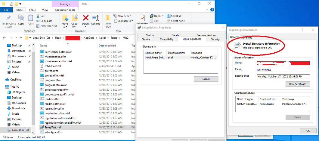

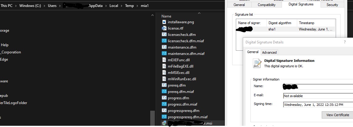

So this doesn't seem to make sense here as I run our Installer to where it is asking for the acceptance of the end user license agreement in which checking the file things seem fine:

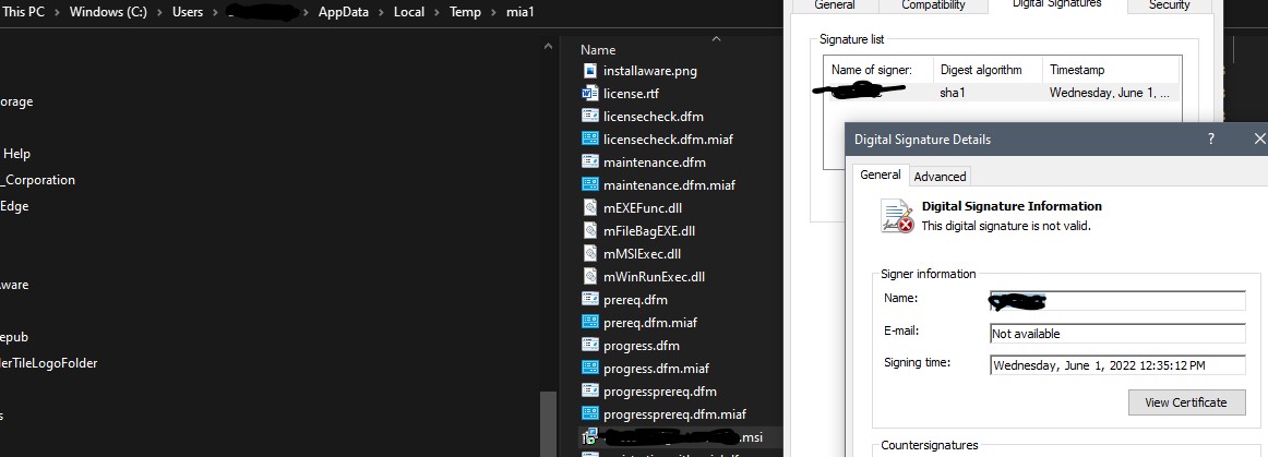

Then once I start the installation the file actually gets a new timestamp and the certificate goes from OK to invalid:
Something is modifying this .msi file during the installation and corrupting the certificate which then keeps this from being installed on a system with tighter security.

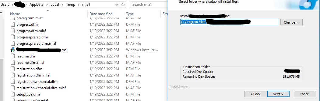

Note the data modified on the .msi in temp and the fact I'm at the select folder:

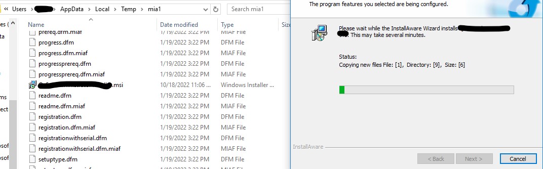

Then after clicking "Next>" the date modified changes:
