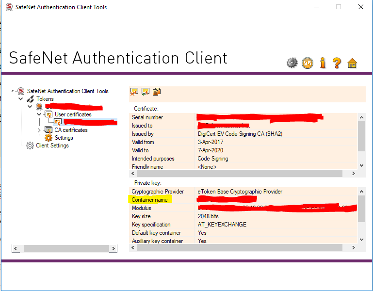

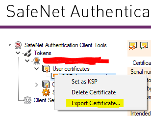

in order to use an EV Token you have, as first, you have to export from your EV Token the "Extended Validation Code Signing Certificate" to a local path.
Then in the InstallAware project "Authenticode settings" you have to specify:
• the Key Container as this is reported in the Advanced View of your SafeNet Client (see below image)
• the full path of your exported cert
• your EV Token password
