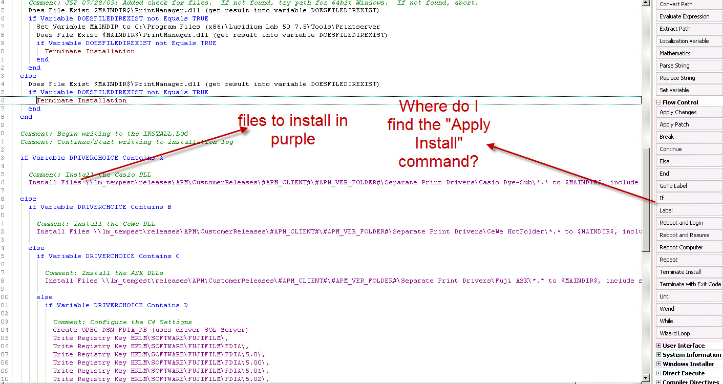

I am very new to IA and have successfully converted and build my first installer from Wise script. When I ran the installers, it doesn't do anything i.e it doesn't install the files on my test machine.
I do have the "purple lines" in the converted script and I suspecting it's the culprit. When I look on the right hand side, I do not see "Apply Install" command so I am a bit confused. Any help will be greatly appreciated. Thanks
Screen shot of my test script

Postby giaviv » Wed Nov 30, 2011 1:46 pm
Your Apply Install command is probably later down in the script. Which template did you use to create your setup?
