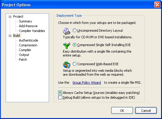

Re: Patching possible with msi installer ?
NO worries Frank, getting clarification is always good.
Here is what I have set for caching, perhaps this isn't what you're referring to ??
Patrick.
Patrick.
- InstallAware cache.jpg (69.71 KiB) Viewed 11747 times
Dear Patrick,
yes, it is exactly that.
As I was supposing the "Always Cache Setup Sources" control is filled ... not checked.
I'm quite sure that if set it is as checked, you will solve your problem.
