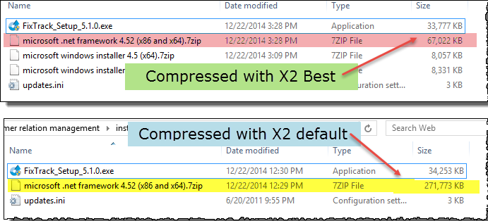

Hi All,
I understand both position, Francesco and Mike, and sometimes it can be difficult to get a message across for many reasons.
Mike, I don't have the time do do the test Francesco was suggesting with .Net 4.6, but I do use .Net 4.5 and after upgrading one of my script today I noticed that the .Net 4.52 runtime had a size of 271,773KB, after reading your post, I change my compression settings to "Best" and re-build my script and to my surprise, the same .Net 4.52 runtime now has a size of 62,022KB, that a is huge advantage for my end users, see image attached.
For your info, I have not done anything out of the ordinary, just changed the compression ratio to "Best".
- IA X2 Compression Test with .Net 4.52 runtime.
- IA_X2_CompressionTest.png (43.28 KiB) Viewed 10426 times

By the way Edhy, I just checked my .net4 files compressed last year with an older IA18 version, and those files are ALREADY at 69000kb.
So, what version were you running before and/or what level of compression were you at before sliding to "Best". You mentioned "default". I see no such designation on the compression window with the slide bar. In IA18 I was at "Best", and now with IA X2 (19) I'm still running at "best". From what I see, there is no compression difference.

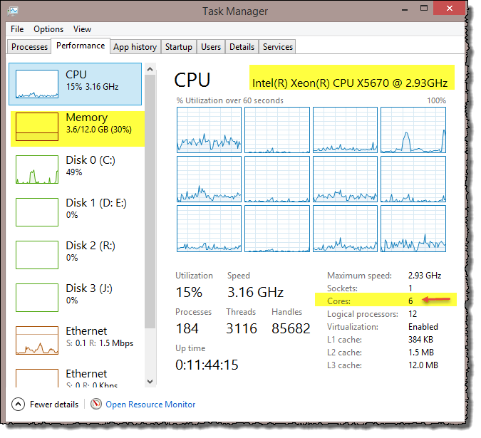

Hi Mike,
I went from IA 18 to X2.
By default compression I meant what I had before upgrading to X2, see picture and sorry for the confusion.
>> I don't use any IA runtimes.
Then that is definately a problem, because IA will not compress an already compressed setup or msi. IA, will re-compress or re-build the Web Media Blocks you select from their Runtime list as long as you have them mark as "Build". AFAIK, one of the advantages of using IA runtimes is the fact that they will uncompress and then recompress the runtimes using 7zip compression to get the best ratio possible based on your environment. We have similar specs, I also have 12GB RAM and 6 core CPU with Hyperthread.
- IA_TaskManager.png (62.38 KiB) Viewed 10426 times
