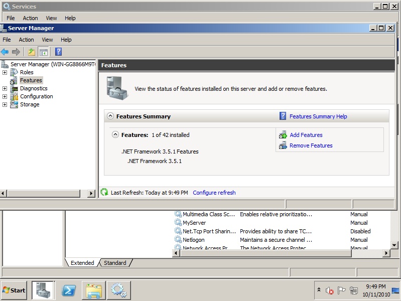

Could not reproduce on Win2k8R2. It worked fine with the basic 2.0 installed. I started over, installed .Net 3.5, copied the services to C:\, ran the .Net Installer test and both the test services appeared in the service list afterward.
Notice the MyServer:
