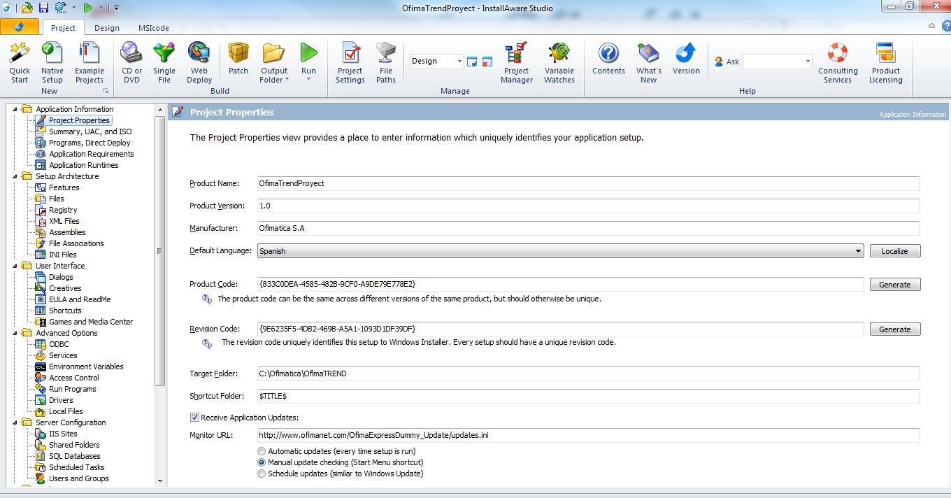

Perform project installer
with the following steps
1. Create an initial project and call this version 1 installer, check to receive updates (Receive Application Updates) and directions to this link for example (http://www.ofimanet.com/OfimaExpressDummy_Update/updates.ini)
2. Then save the file in a WEB Deploy generator in a folder called Version 1 on my local computer
3. Install a machine
3. Make some changes After some changes to the project and add files
4. Generate a Binary Patches with the filename (ofimatrendproyect_Version2.0.exe)
5. Web Updates will create a new Update Packs with the following URL http://www.ofimanet.com/OfimaExpressDum ... ion2.0.exe
6.Cut the file on my web server ofimatrendproyect_Version2.0.exe
7.run updates presents me the following error View Image Error_Descargar_actualizacion.png
I might indicate that steps should I take or I can check this error
thank you very much
Error Publish Pacthes in my web server

- Update Pack.png (157.87 KiB) Viewed 4135 times
- Recibe actualizaciones.png (164.77 KiB) Viewed 4135 times
- Esta imaginen corresponde al punto 7
- Error_Descargar_actualizacion.png (37.2 KiB) Viewed 4135 times
Re: Error Publish Pacthes in my web server
by your screen-shots, it seems that you have missed the prefix "http://" in the download URL parameter of your Web Media Block.
Could you try to add it?
