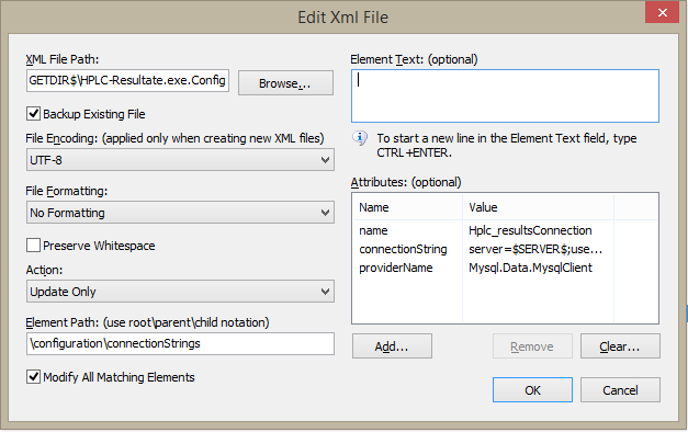

I'm pretty new to InstallAware and work now with X2. So far I'm very impressed and could already build up a first simple installer. However, for my application I want to set the connection string in the app.config file (which is actually an xml-file, utf-8 encoded). I try using the tool to edit xml files. The file looks sth like this:

I use the edit XML file to apply those changes. As path I entered \configuration\connectionStrings. Are the values entered in the dialog ok to achieve this?
Server, User, Password and Database I would read out from a dialog with corresponding textboxes. I tried to find a solution here but tere was no luck.

You have "\configuration\connectionStrings" try removing the firs backslash so it reads "configuration\connectionStrings"

it worked but not correct. It adds the string but not at the correct place:
<connectionStrings name="Hplc_resultsConnection" connectionString="server=server;user id=user;password=pw;persistsecurityinfo=False;database=db" providerName="Mysql.Data.MySqlClient">
    <add name="Hplc_resultsConnection" connectionString="server=server_temp;user id=user_tmp;password=pw_temp;persistsecurityinfo=False;database=db_temp" providerName="MySql.Data.MySqlClient"/>
  </connectionStrings>
Correct it would be the following:
<connectionStrings>
    <add name="Hplc_resultsConnection" connectionString="server=server;user id=user;password=pw;persistsecurityinfo=False;database=db" providerName="MySql.Data.MySqlClient"/>
It replaces the variables correctly but adds the string to the wrong place. The line already exists in the code but with default values. I'll try what happens if I add "add" at the end of the path.
That did it. I was one level above when finishing the nodes with connectionStrings.
