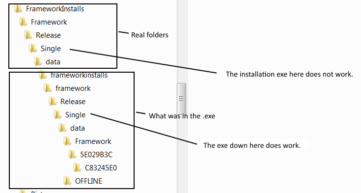

Here is the folder sequence I mentioned:

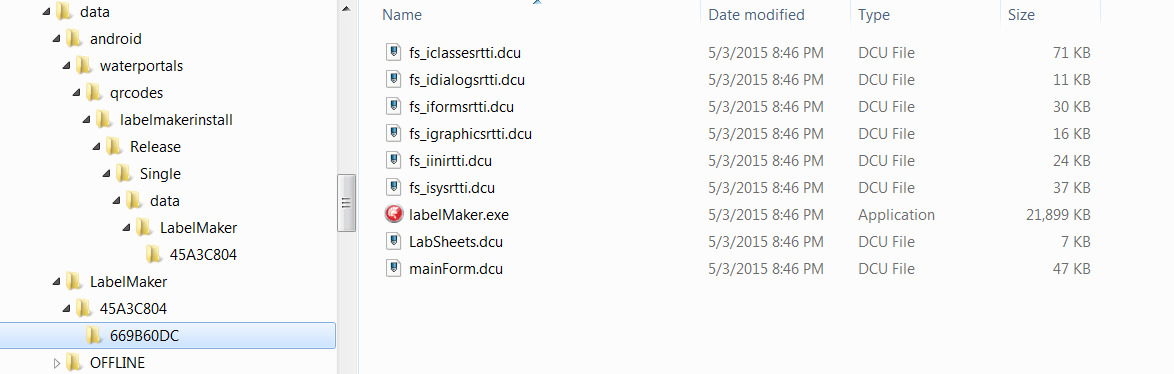

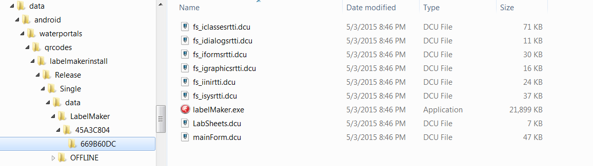

Thanks for your earlier reply and apologies for the delay at this end. It is not that my problem is not urgent. Demands at work pushed me into shelving this and solving the problem with another product for the time being. But I really want to get things working properly with InstallAware. Added information is as follows:
1. I reinstalled Installaware (redownloaded this p.m.) with minimum settings. I created an install project from scratch. It worked fine.
2. I added the dialog editor to my installation. I re-ran the same project from step 1 after tweaking one of the dialogs. I got the same 'system cannot find the file' error as before when I tried to run it.
3. I reinstalled Installaware again, with minimum settings. I re-ran the install project from step 2 with no changes. It worked fine.
4. I again added the dialog editor to my installation. I re-ran the install project from step 3 with no changes. I got the same 'system cannot find the file' error as before when I tried to run it.
I did notice that the files were set up differently in the case where it works and where it does not. Below is what I see when I unzip the install set after step 3 (i.e. this one works).
Below is what is in the install set after step 4 (i.e. this one does not work).

I have a brief update. The same problem plagues me. I have lost a lot of time to this. I have one added insight into what might be happening. It seems that I can get an installable result when I move the Installaware project directory to My Documents. The identical Installaware project files work just fine in My Documents, but not in my usual location. Up until now, my compile and install files have been in a directory where I hang all my development activity. That is F:\Data\... I have a sense that Installaware may be getting confused by the use of Data as the bottom folder. This has never been a problem in the past, but seems to be a result of the most current update I did. This is only speculative - but I'm hoping I'm right because, at least for now, I'm getting installable results by working in a different directory. Your thoughts on this would be appreciated, since this whole thing feels kind of sloppy as a solution.
Re: 'The system cannot find the file specified' error.
Dear Charles,
It seems that I am able to replicate the same finally and the "data" folder seems to be the cause indeed.
At the moment I can only send a note about the problem to our dev team.
