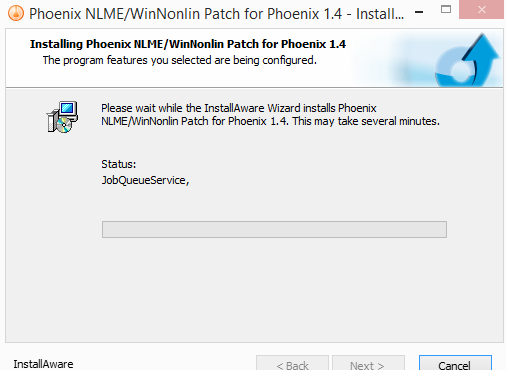

How/Can the message for the Native Engine Control Service function be changed? Right now it simply displays the service name and a comma?! See attached image.
- control service.png (23.89 KiB) Viewed 5863 times
Re: Modifying the Control Service message
Dear Munderhill,
use the PROGRESSTEXT pre-defined variable to display a string description of the current installation task.
Just use in your script;
- Set Variable PROGRESSTEXT to ...my string description
before your Control Service call.

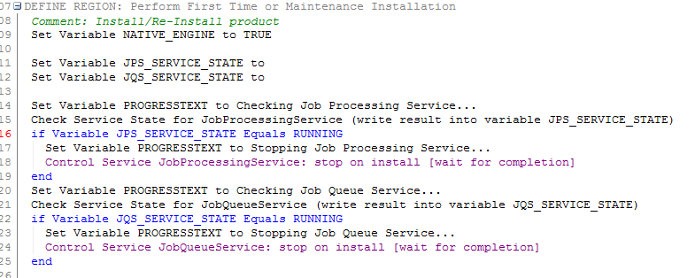

I am still getting the display of "servicename," in addition to the text that I want to be displayed. The msi script screenshot is attached.
- Screenshot_1.png (24.82 KiB) Viewed 5855 times
Dear Munderhill,
by default both engines (MSI engine and IA Engine) status messages take the precedence over other messages and this overrides the PROGRESSTEXT pre-defined variable value.
I have just used the following code and my custom message gets displayed, however the one emitted directly by the engine comes up anyway.
Set Variable PROGRESSTEXT to ...Stopping MSSQL service
Set Variable PROGRESSMODE to MARQUEE
Control Service MSSQL$SERVER: stop on install [wait for completion]
Set Variable PROGRESSTEXT to ...MSSQL service has been stopped
Set Variable NATIVE_ENGINE to FALSE
