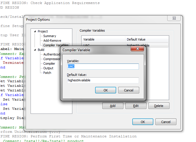

I have encountered one of my biggest frustrations with InstallAware (16) documentation. I am trying to figure out how to SET a compiler variable. The documentation tells me how to create a compiler variable. Here is what it says about setting one:
"The values compiler variables can take are set at compile time, either from the IDE or from the command line"
Great! Now if it just told me how to do it! I know how to do it from the command line, but how do I do it from the IDE?
(BTW, I was able to get around my problem by setting the Default Value to the value I wanted.)
JAB

Dear Jab,
... press SHIFT+CTRL+F11 and then enter the default value you want.
set compiler variable.png (51.75 KiB) Viewed 3643 times
