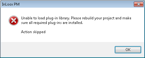

we use Installaware 15 (Build 11.02.12) and we have an issue while installing the prerequisites with the web build.
The setup tried to install .net Framework 4.5 from a download source and failed with following message:
Unable to load plug-in library. Please rebuild your project and make sure all required plug-ins are installed.Action skipped
The target platform is a Windows 7 64Bit machine.
Is this a known issue and how can it be solved?
Thanks a lot.

Hello Francesco,
I've set up a new virtual Windows 7 machine and I got the same error. It's a clean virtual machine with no anti-virus software.
Any suggestion?
Do you need more information about the target machine?
Any suggestion?

Hello Francesco,
I got it. It was a missing bitness check.
I added a check for x86 architecture and it works.
