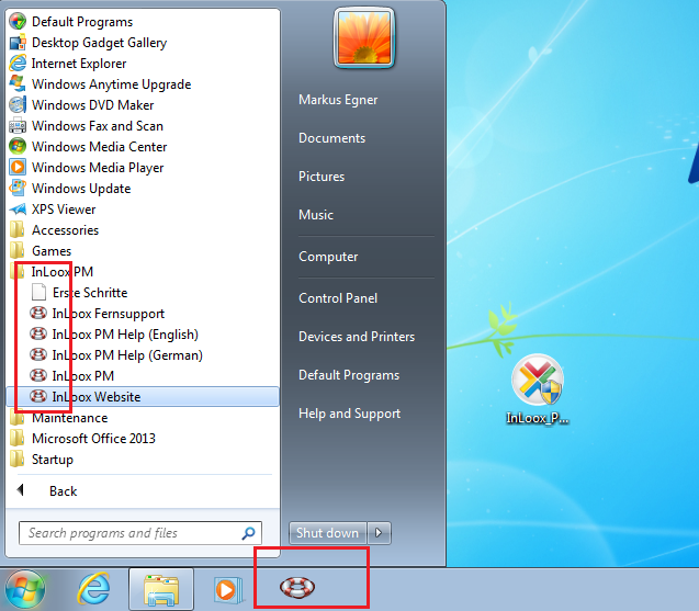

we have a couple of shortcuts created by Installaware (Installaware 15 (Build 11.02.12)) and all of a sudden the shortcuts are all using the same icon. In the code the difference is clear and the files are available in the proper folder. I have recognized that always the icon "lifebelt.ico" is used. No matter what file it is. I have changed that file to another icon and named it that way (lifebelt.ico) thus the new icon was used.
We have no idea what happended. The shortcuts always worked and we didn't change anything regarding the shortcuts/icons. We even revoked every changes to a version which has worked properly. Still the wrong icon.
The following is the code for the creation of the short cut copied from the MSIcode. For each icon the "lifebelt.ico" is used even though the code is correct. "help2.ico", "earth2.ico" and "inloox.ico" are completely ignored:

That's exactly what I have tried as well before I created this thread. My bad I should have written it also. Anyway I just gave it another try, the code looking like this:

Still it doens't work. I have attached a screenshot of the result as well.
