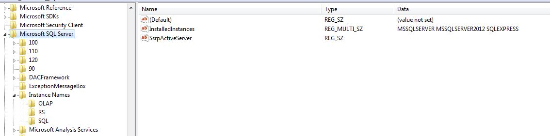

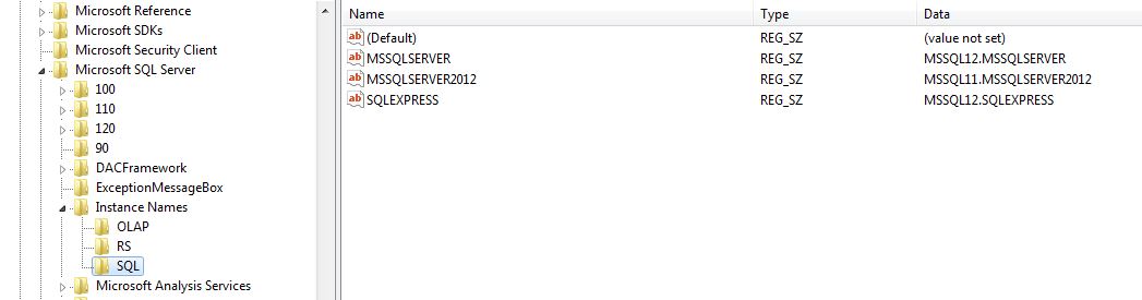

Firstly, I was not able to find the exact registry key but I did note two different location, very close to the key you mentioned, for the information regarding the SQL Instances in my register (see the images).
