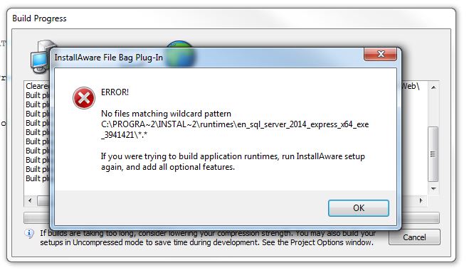

I've getting the following error during the building process:
Error 01.JPG (54.1 KiB) Viewed 3535 times

Did you check if the required MS SQL 2014 Runtime package is effectively available under "%ProgramFiles%\InstallAware X\runtimes\en_sql_server_2014_express_x86_and_x64_exe_3941421"?
Please also check if you are able to reproduce the same issue with creating a new project from scratch, just create the project (without defining any other setting), then add MS SQL 2014 runtimes. If possible, please also test with adding a different application Runtime.
Ok, so I've ensure that the Runtime package is available. I've started a new project. Added all the required runtimes as well as setup my features and files. Sadly, I still get the same error when building the installer.
Just in case there is interest, below are is the runtime that is giving the issue:
Runtimes selected 02.JPG (16.7 KiB) Viewed 3535 times
Also note that I can confirm that the file permissions for the folder is the same as say selecting SQL 2012. I have also tried swapping out SQL 2014 runtime with SQL 2012 runtime, which when built, builds just fine.
At this point, I'm not sure what else I can do. Some help would be greatly appreciated!
