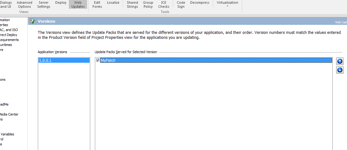

Dear Daniel,
if I have not missed your question, it doesn't change anything in terms of "Web Update feature" settings, when including a patch in your update pack list.
Once you defined the patch installer in the "Update Packs" of your "1.0.0.1" project, then define the appropriate version relation for the patch in the "Versions" page of the same project.
It should look like as below, where on the left column are listed the versions of you product that can receive the patch update.
If necessary, use the Up and Down buttons to re-order the order in which packs will be installed, if more then one are defined.

Postby FrancescoT » Tue Sep 15, 2015 12:48 pm
Dear Daniel,
The Update Packs page allows you to define the updates that are available for your applications on the field. An update can consist of any downloadable file, and will typically be a setup executable; such as an incremental update built using the Patches page, or a full blown major version installer that completely uninstalls the previous version.
So from the update process point of view, it doesn't matter what kind of executable you want to serve for a specific version on the field.
That said and supposing that you want to delivery a patch update to your customers where your product "1.1" is installed;
- load the patch project and Build the patch (patch.exe).
- in patch project, define an "Update Packs" that points to your patch.exe (Web Updates ->Update Packs page).
- in the patch project, define to which product version the previous "Update Packs" has to be served (Web Updates ->Versions page).
- Finally this time, build the patch project as a FULL UPDATE (e.g. compressed single exe) and then, use the new Update.ini file within the release folder.
